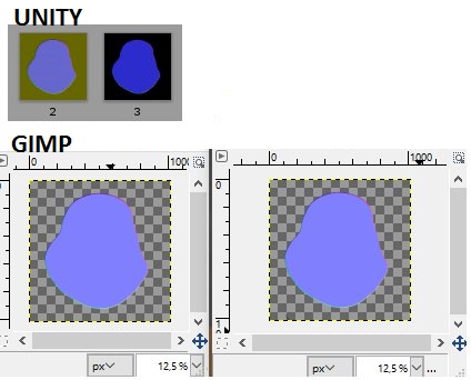

Hello. Can I export texture with alpha but without transparency? When I exporting texture with transparency FF cutting data from rgb channels...That's bad variant for me, f. e. substance designer allows to do what I need, but I don't want resave all textures from FF through designer(((

Sorry that I do not understand what you mean, because for me the alpha is always the transparency part, and I did not know that there could be an alpha without transparency. Can you explain more and give some possible example?
hey, thank you for your answer) I attached archive with to files, first saved in SD and second in FF. They both have alpha channel but for example in unity looks different (without transparent mode). In my unity shader I really see rgb data outside centre contour in first case...But in preview in explorer or some programs like gimp they looks similar xD))

Sorry, I have nothing to say about the alpha without transparency. You could probably try another format (PNG vs TIFF vs OpenEXR).

Save as TGA with alpha.
https://www.filterforge.com/filters/14794.html
