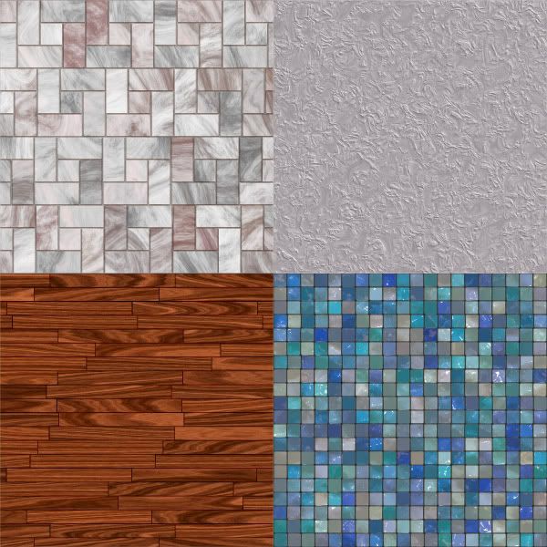

The following composite was done fully in the standalone version of FF from four separate images.
So, how do you combine four separate image files in FF?
Answer coming soon.
So, here is how it works.
I started by rendering 4 different textures in FF. In this case, Ayeaka's Stone Flooring, Crapadilla's Rough Plaster, Kochubey's Parquet and Vlad's Decorative Tiling. I also rendered their alpha channels, although that is not visible from the end result.
Then I took each image, loaded its corresponding alpha channel as a selection (Parquet didn't have one, so I loaded the image itself as selection) and run it through a filter that split the RGB channels and the selection into a two-by-two greyscale image. For instance, Decorative tiling looked like this:
(That's R, G, B and alpha split apart.)
So, now I had four images similar to the above. Let's call these "preprocessed" images.
Next I made a new document of the same size and loaded one of the four preprocessed images as a selection. Then I ran it through a filter that composes the RGB image back together and places it in one of four positions on the two-by-two grid. As in:
I saved this image and loaded it back in, loaded the next preprocessed image as a selection and placed it into the second position on the grid:
And the same for the remaining two.
You can see the end result in the previous post.
Okay, so this is a pretty complicated example, but you could just preprocess one image and load it as a selection in another image and you would have two input images. The only limitation is that the second image is half the resolution.
I'll throw these multi-image-input filters in the queue if anyone is interested.
