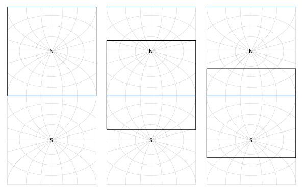

After pondering this for a while, it seems that if you can generate an intermediate distortion that looks like this, you could "tilt" it (by offsetting it vertically as shown in the diagram):
(N=North pole, S=South pole, blue line = equator, black line = image area)
You would have to have both hemispheres.
As to how to get to that point, I would suggest spherizing your texture (i.e. polar coordinates) and distorting it so that the lines at the equator cross it at 90 degree angle as in the diagram.
Then you would have to "bulge" it to look like globe.
It may not result in "perfect" spherical mapping, but I assume you could get reasonably close.

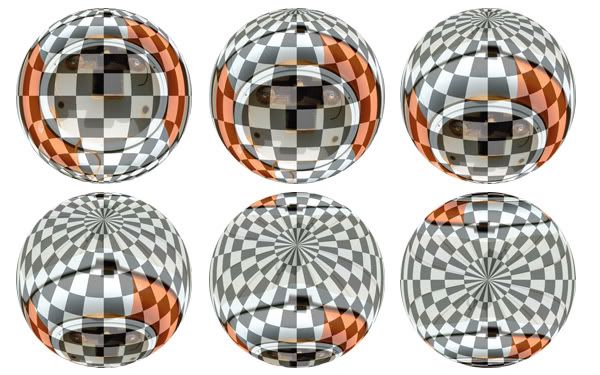

So, of course I had to try it -- this one almost works.
If I can get the distortion to match the diagram, it probably will.
Dude, you rock!
Seriously, I'm completely impressed.
Almost? (It looks pretty spot-on to me.)
Are you using offset or refraction to get the poles to compress?
It isn't geometrically correct nor perfect, but it looks pretty good now.
You can see how much I had to bloat it to make it look like a sphere by looking at the size difference of the squares at the equator in the first and the last render.
And no, it certainly wasn't too easy to do.

That version has serious problems if you look at the first and the last render closely -- the lines at the edges go completely weird. I had difficulty making my intermediate distortion match the diagrammatic idea.
I used Spherize/Unspherize UberEdition to make two polar maps one on top of the other for north and south hemispheres kinda like I show in the diagram. It was a real bitch to make the next step work and match the meridians up correctly. It's all done by offsets. There's about 15 separate offset steps in the filter now!

In this case it must have something to do with geometry being one of my favorite subjects and my fascination with different mapping systems ("Mapping" as in world atlas). I first tried to figure out if there is a way to simply rotate a texture spherically but I couldn't do it, so next I asked myself what is halfway between where I'm starting from and where I want to get to. The primary problem seemed to be the poles and the tilting on X-axis, so I got the idea of making an intermediate flat map that already has the poles. In a way polar mapping is a combination of cylindrical mapping in three coordinate directions, so somewhere there the solution loomed.

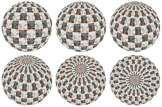

So, downloaded the filter and started messing around with it. Wow complicated. I noticed that there are a couple strange things going on. (see image)
1) The underlying pattern is actually reflected once across the 'globe'. So, if you look at the test pattern, C1 and C8 are reflecting.
2) At certain angles, for some reason, the hemispheres 'double' and you get the 'north' hemisphere in both the north and the south, mirrored again.
I suspect that on both, something is a half a step off, or something.

I can fix some of those things, but not necessarily all. After all, this is NOT true spherical mapping but a simulation that is trying to look like one.
Here's what I could do to fix the tiling, so it isn't mirroring:
Since it is simulated spherical mapping, it tends to look better with repeated pattern.
By the way, in the current version the number of repeats is a bit odd, at Repeat value 2 (as in the above image) you actually get 3 repeats. I probably should fix that as well.
Is this how you want to map it (rendered in a 3D program)?
I think I can get it at least somewhat close to that.
Here's a mod on the Rotatable Sphere Snippet that is closer.
(You'll have to have Seamless Tiling turned on so as to not get mirrored sections.)
Rotatable Sphere Snippet 2.ffxml
Above snippet output looks like this:
