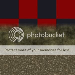

Oh! I get it!
I think this one is a little more manageable than Constantin's (the wave controls are a little annoying... smile:| )
Island-3 textures Test.ffxml
Here's what it looks like:
My bad, forgot threshold controls (moving the borders up and down)
Island-3 textures Test.1.ffxml
