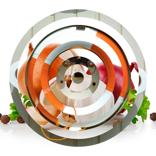

Above I have suggested to make the concentric circles using Polar Coordinates, and here is the filter I have done to show how this can be done
And here is the filter for the example shown above made with the well done Polar Distort by CFandM
Colorful Concentric Circles Polar.ffxml

Apart from all the methods shown above, is there possibly another posible way not shown here?
I am asking this because I want to have some circular stripes with VARIABLES sizes of the stripes, and as far as I know is not posible to do it with any of the methods above, or I do not know how to do it, I have tried some ways, but none of them work
What I mean with Variable sizes is that you could control with a slider (or two) that the stripes does NOT have exactly the same width, and so you could random different width sizes
As you can see on all the images shown above all the concentric circles have the same width,
With the Colorful Concentric circles I have uploaded just below the image shown here you can customize the size and width of the circles BUT:
1 - You have to do it one by one for each circle with it´s own slider
2 - As they are not related to each other you can´t easily resize without having the problem of overlapping or hiding the circles with some settings, and you MUST resize them in the same order as they are shown, and using the remapping does not work in a sucessful way.
3 - and more important you CAN´T use images that follow the circular stripes, as this method is using frames to make the circles, so any image loaded will be shown as a plain image and only the part of the circle viewed as shown here below
