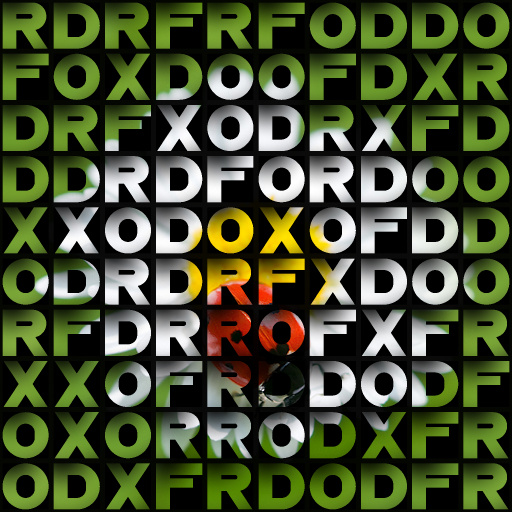

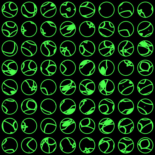

Hi, I wonder if feeding random different amount of images (about 15 or 20) into bomber plus not mixed, ordered in different lines, is the same as it is already in the normal bomber? I mean in the way that is already done in the below filters?
In bomber plus there is only one input and there is no chance controls as in the original bomber for each of the particles input, so this is why I am asking
Here are some examples of what I want and mean found on the FF library
Alien Hieroglyphics
Color Squares with Photos
Alphabet Photos
Thanks for any help

Yes! it did work as you told me and is what I wanted, I have copied the same bomber settings of the Alphabet Photos above and put them in the bomber plus using the Map switch and randomizer and it works correctly
