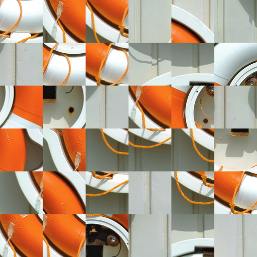

Hi, I have seen some filters that have the beautiful and very good option to jumble the source image in more tiny squares like for example
Jumble by Kochubey
The problem I see is that ALL the tiny square are always the same equal size
and I wonder if they could be done irregular, I mean with squares of different sizes

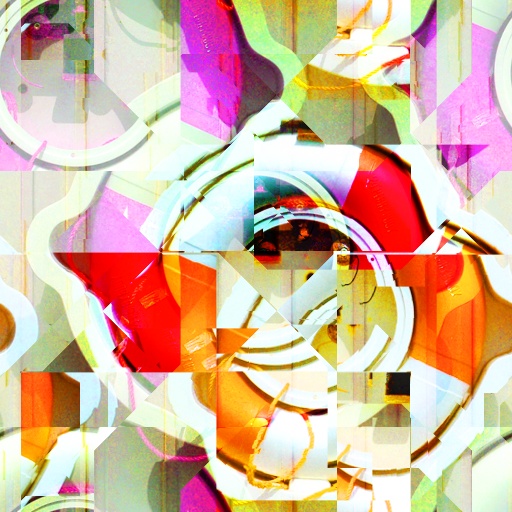

I have found that modifiying the original Adaptative Tiling by byRo, changing the solid fill to jumble in the tiles component I could get in some way what I wanted but not exactly
Here is shown that the lifesaver is jumbled beautifully and it has 3 different sizes of squares mixed together
The problem I see with this is shown here above
1 - It is limited to only 3 square sizes
, it would be good to have more different sizes available, maybe 5 or 6.
2 - Is difficult to mix these 3 sizes with the 3 sliders to get a good result that combines all 3 in a wanted way. Maybe there could be another better way to do it, considering that now the original point of the filter to be "adaptive" is lost and not used with the jumbled option
3 - You can not resize the images bits inside the new created squares, of course I do not mean of course to resize them individually, decrease or increase all the bits at once or maybe also in parts (one resize for each size of square)
I have thought to use an scale component to solve this
4 - You can not reposition the images bits inside the new created squares, again as in point 3 is not to be done individually and would be in the same way
This is done adding offset components
Here is the filter I have made to make the image example above
Is simply by changing the Solid fill in Tiles to Jumble and then after make all new presets with this change
Adaptive Tiling Jumbled.ffxml
1 - It is limited to only 3 square sizes, it would be good to have more different sizes available, maybe 5 or 6.
Note: you may probably it already the default values where Scale and Offset has no effect
Scale = 1 (real size)
Offset = 50 (original without moving)
