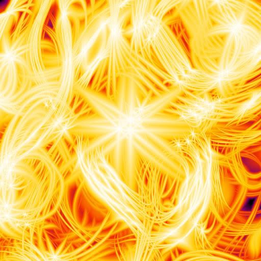

So far, I've attempted to grow a tree in a fractal fashion.
Apart from being painfully slow, the experiment started to have a life of its own, so I figured I'll throw a render in here -- this one I called Fractal Mystique. (Renders way too slow to become a usable filter yet, but maybe something will yet become of it.)
The main problem seems to be making the branching pattern, which is why I was going the fractal route. I had no luck with noises as I always got closed shapes (variations of tessalation -- sort of like a cracked earth pattern) when trying to make branches.

Hmm, yeah, it doesn't really remind me of trees, cept maybe x-mas on acid in some Dr. Seuss nightmare flashback. But, it's looking pretty cool on it's own, just needs a little more tonal/light-dark balancing and it'd be a neat special effect swirly design maker. smile:)

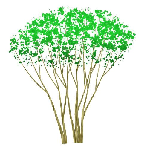

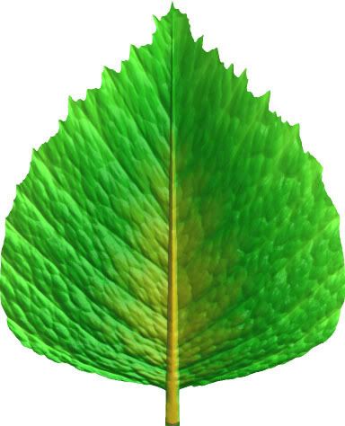

In the meanwhile, the development and experimentation did lead me to a pretty good leaf filter, which I submitted, but a whole tree is still quite a distance away. Here's a preview of the leaf:
Back at it.
yup, looks good smile:)

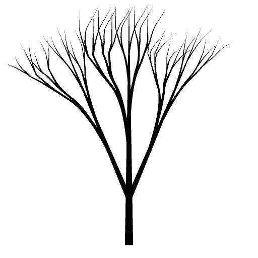

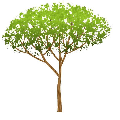

One step closer...

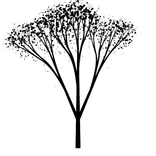

After some serious headaches, I got this far.
For this one, the trunk and the first two branches are built individually, the rest is created by splitting the branches at increasing distances from the first branch, four iterations in total. Leafs are just a noise pattern in the vicinity of the branch ends.
Unfortunately, it is mostly good for testing your CPU speed and your patience.
If I can figure out how to make it work at a usable speed, it could become something.
hehehe, boy, does that sound familiar smile:D
i'd love to see the method you used for this so far. i've got a couple ideas, but no point re-inventing the wheel.
Looks like your well on your way to getting it - rotated and fiddled with you might get a good fork lightening smile:)
Kraellin,
You can see from this work-in-progress version how it works (if you have enough time to wait for it...) This one is slightly improved in terms of results but not in terms of speed. Lotsa optimization to be done...

thanks, threedee. looking at it now. the first thing i can tell you is, turn off anti-aliasing smile:) that thing is just a weeeeee bit slow smile;)
i'd leave the noise for leaves right now.
i'm running a single core, 3.5 ghz machine and timing the render................ i'll get back to you in an hour or so smile;)
ok, with anti-aliasing turned off, 3 min, 27 seconds on my rig.
replace the chaffs near the results with a perlin.
on your 'spread' routine, you can lose 3 components there. just use an invert off the one profile gradient and plug that into the other offset on the profile gradient.
ok, forget that last one. i think i may have a better way.
lol. ok, i managed to shave off three seconds. smile:) yeah, not that much, but i did simplify the 'spread' routine and added a control to determine how high up the trunk the branches start.
i'm sure more can be done and i DO thank you for showing me this! i'm having fun with it and learning as i go. you've got some clever routines in there. i love how you managed the hood of the tree and leaves smile:)
i'll work on it some more. always interesting seeing what folks come up with and how they do it! i had tried a 'tree' quite a while back but didnt get anywhere, so this one is real interesting to me.

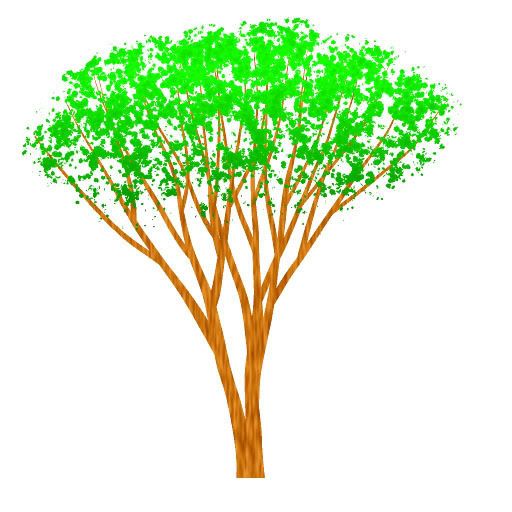

attached is my latest revision.
Tree test 9 rev 2a.ffxml
and i just couldnt resist taking it a bit further by adding some color. i plugged that into the perlin i added to replace your chaffs and then added a set alpha onto the threshhold following. fun stuff smile:)
of course, that added some extra time back, so i'm now back to 3 min, 28 seconds. lol.

Got back onto this yesterday and decided to try and optimize the performance so that it would become usable. Your suggestions are most helpful and I have tried out your ideas and use some of them to make the filter run faster.
Yes, you're right, there's no recursive routine, just an attempt to simulate it. I finally figured out a way to split the branch in two directions at once, which took the time down to 1/8 of the previous. Also, I managed to make it so that you can offset the branches on the different sides, which made it look more natural.
I don't dare to put any fancy texturing into the filter as it is still a bit on the side of annoyingly slow (2 minutes with antialiasing on), but with a few more things I can do to simplify it I think it's going to work. Here are some of the latest renders from the simplified version:
that must have been a bit tricky, getting things to line up with other branches. i would guess some mirroring might help in getting a fresh look also.
and looking at your renders, i now see how if you doubled or even quadrupled the trunk by using extra iterations, you could 'naturally' seem to split the trunk into branches as you moved up. in fact, you could even overlap a whole lot of multiples at the base of the tree and simply do the spread up higher to make the branching. very clever. i used the repeat slider in the early profile gradients to get some repitition, but your way is probably better as it will get more natural looking branching. too much symmetry in a tree makes it look unnatural.

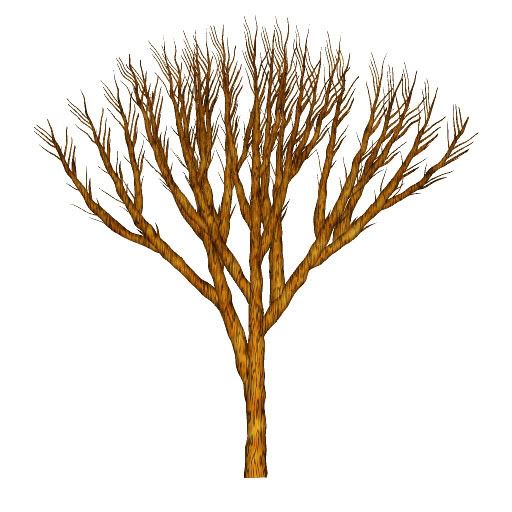

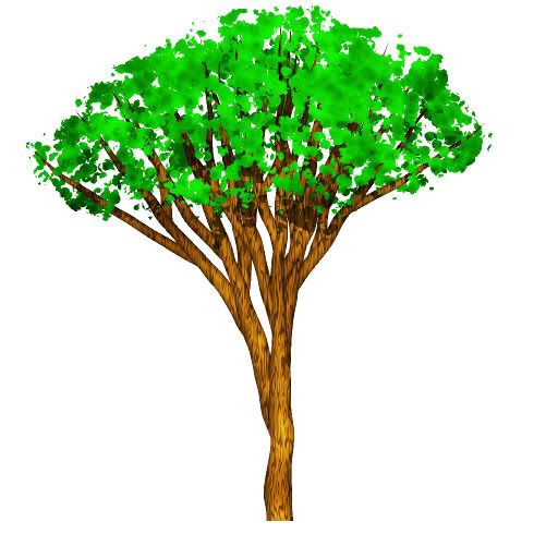

I did get the tree working the way I wanted it, so it is in the queue now; two versions thereof, one with leaves, one without (putting both in the same would have killed the speed improvements again). Here's a preview:
With leaves (the "summer" version).
And without (the "winter" version).

I like the shading you did on the branches. HUGE leap forward in realizm, there. I know it's slow for now, but someday a cast shadow would be nice for it, too.
(Unless your intent is to make things like sprites for 3d apps, which, of course, don't need the baked in shadow.)
Bark works nicely, nice going smile:)
nice one, 3d! i like how you dappled the leaves a bit more, too. looking forward to seeing what you did.
