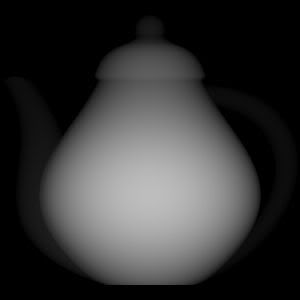

I am considering putting together a filter that you can use to construct complex objects with in multiple passes along the line of:
Building something one element at a time, such as this teapot from five different basic elements, combining bump maps, which represents the height of the final object:

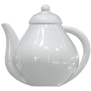

Which would have textures applied to it as well.
