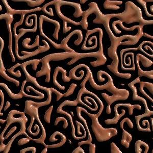

How's this? I took Sjeiti's vintage spiral wallpaper and made a few changes near the end. I added a control for step blur (to make it more like Corvus's original picture), repeat (the steps), and distortion/distortion scale controls.
Vintage spiral swirl.ffxml
Here's a sample:

Here's the best I could do with that. It's kinda like it but not really.
With a perlin noise.
With soft-edged circle.
Gotta love experimenting smile:D
Well as far as the checker effect I tried out my seamless tile concept filter to get rid of that...Then a little blur on the final output before connecting to the distortion..Not quite fast at the start but....Heres a pict of that..
Then the filter
CF_Fast spiral+Offset Test3.ffxml
Hey, that's a clever way to do it. I made a couple of minor changes to make the offsetting smoother:
#2
Here's the file.
I put a tone curve on the fast spiral to get rid of the hard edges.
CF_Fast spiral+Offset Test4.ffxml
