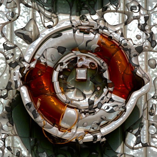

Do you mean?
---> This is the effect that I also got, but it was not what I wanted.
or this
---> Yes, around like this. But, if you see, while some area looks good ( the up right and the low left corners ), some other is not fitting much. On the left and the right there is a hole, but the filter simply covers the hole and becomes brown. It should give the effect that it goes inside the hole.

Something like the third example posted by Carl. But having the effect that the design made by the filter goes deeper inside the empty spaces of the original picture.
Maybe it can be obtained just working on the blend modes that Carl posted.
Or do you have any other idea?
If the result is good, I don't mind if it also makes the filter slow.

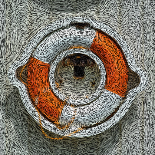

Some good result could be here :
[/QUOTE]
and a bit less here :
But it probably depends filter by filter. The first photo is composed of very small pieces, and that helps.
What you would have to do is Feed the filter 2 images - one is the original image, and the other is sort of a depth map, where darker is deeper.
Then you can use the depth map for the contour of the filter, and the original image for the colors.
: it may be good. I'll try.
it does affect the structure of the weave when displaced but it might still suit you or not - smile:)
higher fibre rate
it actually makes quite good effects even if it's not what you had in mind smile;) smile:)

Thank you, Carl. Yes, I think the last 3 pictures are very good.
higher fibre rate
: where did you change? I thought you did changing the mortar in Unstable Weave, but it was not that.
Here is the filter, don't think Dilla would mind me bastardizing his filter smile:)
Unstable Weave Image.ffxml
