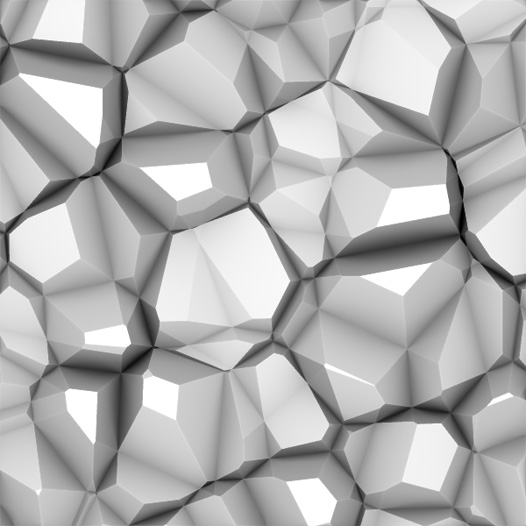

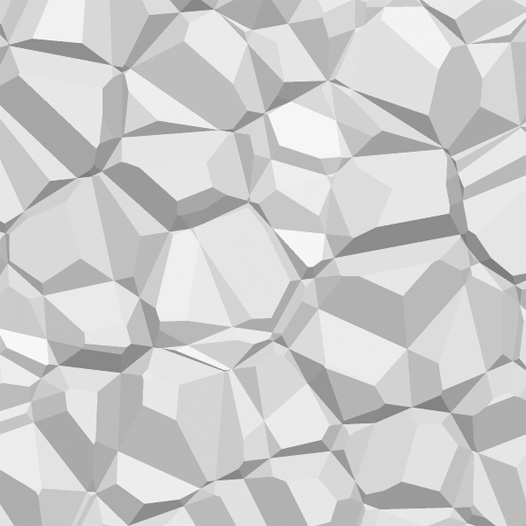

A small example of AO.
Surface without AO:
Surface with AO:
The shadows look much nicer, but the highs look depleted.....probably because of the plateaus in the sample.....would like to see it on a sphere.....

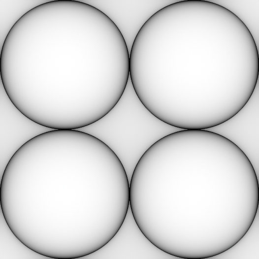

Yes, the plateaus are the problem here -- any flat surface that is close to horizontal orientation works like a mirror smile:)
4 "compressed spheres" (i.e. a half of a sphere with surface Height set to 25) with AO:
i also notice on this last, something i've seen when working with the noise components... lighting doesnt just re-light or re-shadow or highlight or diminish, it also is changing the basic shapes and forms at times, or at least the 'apparent' shapes and forms. i would think this would be something to avoid in a true lighting scheme. it's kind of cool in an artistic view, but for true lighting, particularly in 3d environment, i'm not so sure it's desirable.
p.s. when i said 'last' here, i was referring to the stones images, not the spheres. that spheres one was posted while i was writing.
onyXMaster
Filter Forge, Inc.
Posts: 350
I don't think that I get what you're talking about, Craig -- how lighting should _not_ change the form?
onyx, look at the two stones images you posted. they are not exactly the same in form any more. the lighting actually changed the shapes in places. you can tell they are the same image because mostly the forms of the two line up exactly, but not everywhere. do a side by side comparison and you'll see what i mean. or better, do them in layers and with a lowered opacity settign on the top one.

Ah, _that_ one smile:)
Well, AO vs flat lighting _must_ change the result, shouldn't it? smile:D
hehe, well, i suppose if you changed everything to white or everything to black, the form/shape of the image would change smile:)
