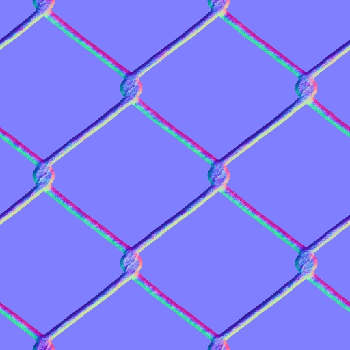

Mike, this is amazing. I can't believe this is a procedural texture.
Noticed a minor problem with the normal map -- look at the regions inside the "cells", they should be flat:
http://www.filterforge.com/filters/871-normal.jpg

Thank you both so much smile:) If there's any qualifier, I could never imagine making textures like this with another procedural texture generator. (Or if I did, it would take twenty times as long. smile;))
That's good to know - I was unsure whether the diffuse alpha map was enough for the empty sections of the texture. (It was enough for the display in FF and Photoshop, which was enough for me at the time smile;))
I've made the adjustments so now all the maps (specular and metallic as well) have the alpha - and now these maps all look flat. Is that what I should have done, or should I just flatten the color for these maps? I'll wait to hear your word on this before I resubmit.

Minor performance advice:
You don't need to use Set Alpha for all the Result component inputs, the Diffuse input will suffice -- resulting alpha is taken from Diffuse input only.
As a sidenote, setting alpha to anything below zero for grayscale (slider) inputs (like Height, Reflectivity for Result) leads to scaling of grayscale data obtained by averaging R, G and B values by the A value (alpha premultiplication), so setting the alpha to zero where there's no chainlink effectively leads to zero height, reflectivity, etc. (not saying it's wrong, just unnecessary since adding components hurts performance).

If that's the case, why would Vladimir have said that the normal map should be flat in these areas? (Since the diffuse alpha was sufficient in the original version, I imagine that the normal maps can be whatever I originally pleased to leave them as.)
