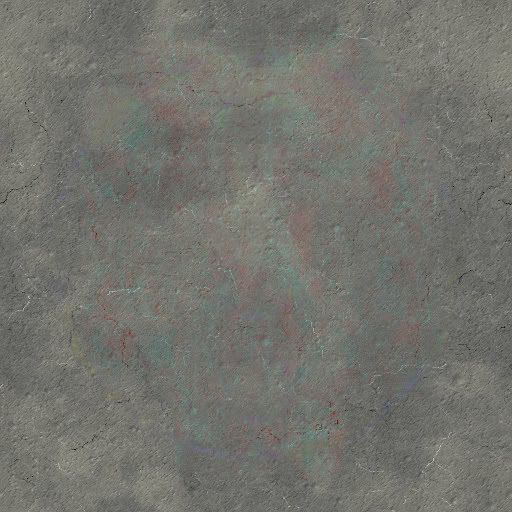

Well some good news and some bad news..First the bad news is the end of my beta is almost near..The good news is I finally found some glasses to work with..Here is a pict of the progress so far..If anyone wants to take a look and see how and IF this works that would be cool...

CF, you're getting closer. the last one, the chess set is the best so far. the two previous ones i could sort of, maybe, somewhat see it, but the last one i can see it in the red chess pieces a bit.
i tried reversing the glasses, but that didnt help.
