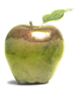

Filter in Progress: Midas
Based on a selection (just around the apple and leaf, not the shadow).
(the rest of them don't have the random test apple.)

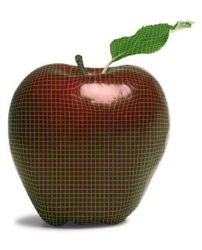

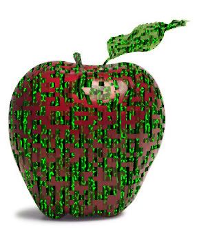

Filter in progress: VR world (Matrix is cliché, but was the inspiration)
Cool!!! I like the "Midas" filter!!! smile8)
yup, 'midas' is a winner. though, i do like the fading 'matrix' grid also.

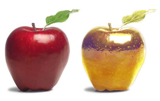

Thing about Midas is that it's a surface filter. The reflection is built in. I couldn't even remotely get the look I wanted with the actual reflection parameters; it had a tenancy to NOT interact with the color as I liked. I wish we could specify when the reflection is blended in.
I'm also going to split the refraction blur from the source blur, since it's a pretty fast filter now (well, for me. The apple takes like 3 seconds to render).

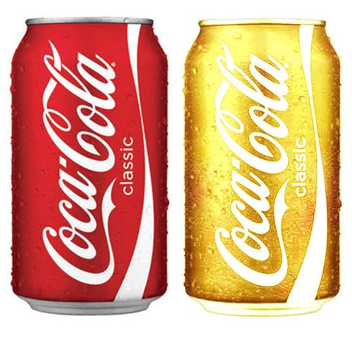

So, this is from Midas, too, but I think it looks more like marble... Not that we need another marble filter, but I thought I'd post it anyway.
How the hell am I going to put this up into the library, when it needs a selection to work correctly?
