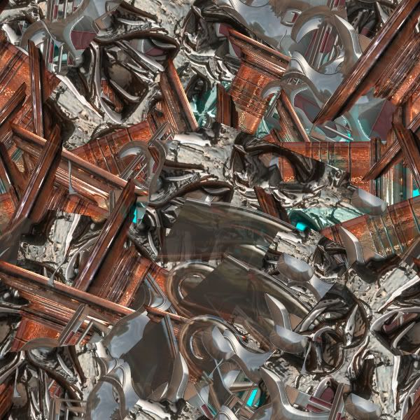

Using some new features to generate a Large/Small tiling using images. I threw in several of my pattern renders into the source.

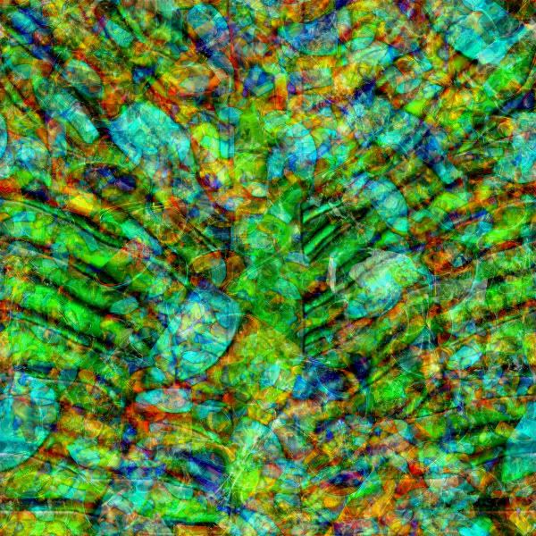

I made a generalized image bomber filter. Meaning that I made it with lots of controls for doing a varity of effects for experimentation. a couple of the images are just straight mix of other images and textures I had already made. And others were the same thing but also utilizing a background image. One of the real cool things you can do with the BG image is use the Particle Mode to change visibility in various respects similar to layer adjustments in photoshop. In certain modes your affects will mostly be seen in certain areas. But I basically just made them trying a bunch of different slider combinations. Here is a screen shot of the filter construction.
infiniview
digital artist
Posts: 202
here are a few more. smile:)
This image is an all green leaf type texture before FF. Then just using a number of colorful textures plugged into the color controls and messed with until it looked more natural.
This one I did after the leaf I think I used a light stone texture bg leaving some of the colorul elements and adding some other differing stone textures into color inputs.
This bg image is the structure that you can see but it was just BW greyscale before.
Then the daisy is of course one of the new installed images again using particle mode it blocked out certain elements on areas that were too light in color like the white and to a lesser degree to the yello and green yet applied the elements to the bug
