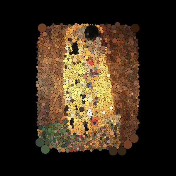

Some improvements. A new circle is added to the table only if it is a valid circle (no overlap, above minimum size), so 600 circles fill the image in better than 2000 totally random circles did.
The index number is now used for shading as well (combined with an 5-color gradient and an elevation gradient).

Now this is starting to become fun. Image as color source.
Nice!
This will be the next FilterForge number one hit filter.

Okay, so I got the pseudo-random number function working, so now I can use the original image for size information. Darker areas make the initial circle sizes smaller.

Circles are easier than random shapes as you can calculate the distance from their perimeter very easily. But yes, the ultimate goal is to be able to do this with any shape. Or even a number of different shapes.
I like how the Lionfish comes out.
Maximum circle size variation gives a fractal-like look.
Small size range.
