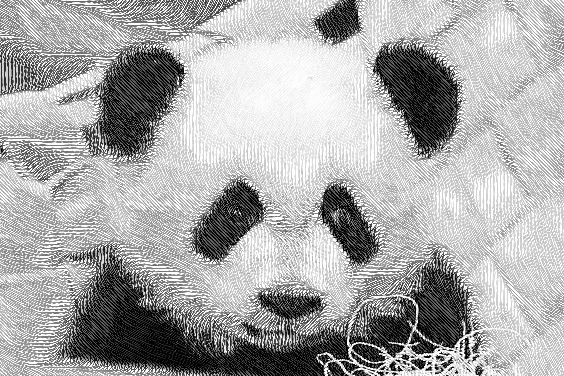

Rachel that is nice on B&W.I was playing with Carls filter he shared here and came up with this little panda cubbie.
Mardar who doesn't love pandas, nice example, I might as well release the filter to the library, with both ways of displacement and some other bells and whistles.
