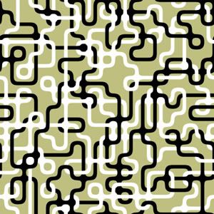

FF builds bitmap textures. This is a bitmap texture (using the awesome 'nodes' filter by Uberzev):
Texture 1

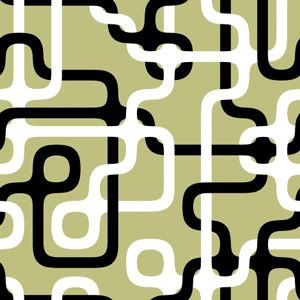

Here I've dropped the tile size in FF, so that the texture appears smaller. Note that there is no repeating design here:
Texture 2
When applied to the same plane with the same mapping as example 1, the pipes are smaller, but not repeat appears:
Example 4
Awesome! Clearly, this is a way to get rid of the tile! But it does reduce the resolution of each 'pipe', which means up close you can see the difference between the two. Example 3 will look sharper than Example 4 at the same distance, because it's devoting more pixels to each relative inch.
