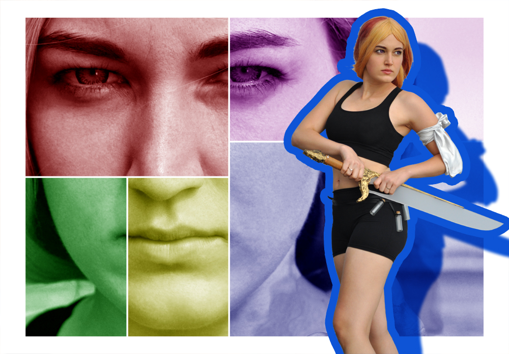

I would like a filter created. As someone with very minimal programming experience, the filter editor is NOT proving to be easy for me to use.
An example of what I want it to do can be seen here:
http://www.erinkoski.com/images/DSC_6...00TEST.jpg (I have also attempted to attach it to this post, but am not sure if it worked)
Ignore the figure in the foreground - that was just a throw-away test. What I'm looking for is a filter that will do the background - border/frame, dividers and desaturate the image and re-color each chunk of it a different color.
Ideal customization:
1. width of outer border
2. width of dividing lines
3. rounded edges or angled edges (to dividing lines/inside of border)
4. angle of dividing lines
5. number of segments the image is divided into
6. the colors used for the segments
7. contrast slider applicable to entire background image
I don't have a large budget for this project, but would love if someone was interested in helping me. Please respond here or to my email [email protected]
Thank you for your consideration.

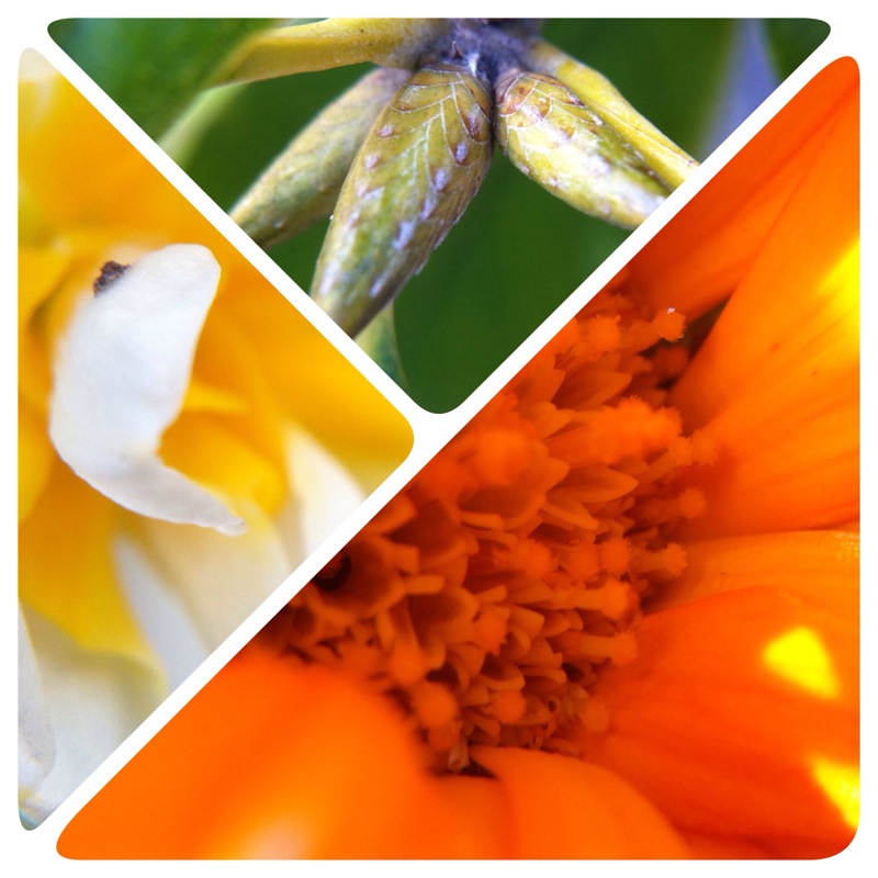

Please, is something like this shown below what you want?
Be aware that the color one is done in Photoshop and not in filter forge
