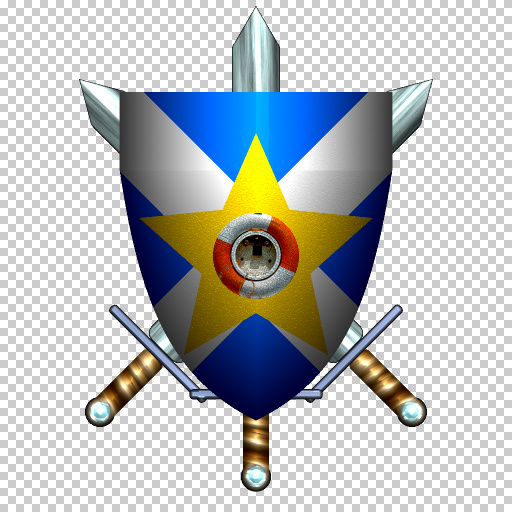

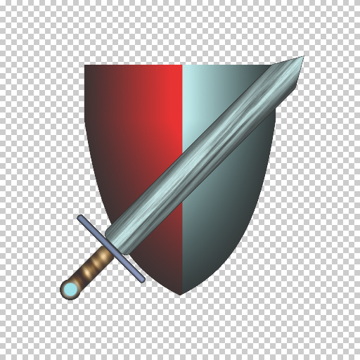

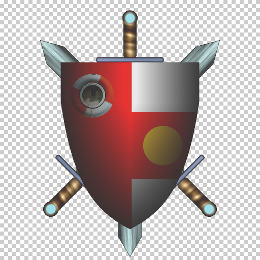

The original idea of the sword is Replay's Swordid Past 1 by CaliCoastReplay.
I reduced the customization options for the sword ( the size and the shape are fixed ), so his filter is still the best to make a sword.
I added my shield in the middle ( there are 3 different sizes available and 2 positions ). It is based on my other filter The Spherical Connection - Lite Version, but with many changes.
I added a simple scimitar :
Then I added the chance to choose the number of swords, to rotate and move them, and to bring them in front or behind the shield.
As you can see, there is also the chance to import any image and to add it anywhere on the shield ( it can be used to add to add any heraldry picture ).

Thank you! I'm happy that you like it.
Without your filter, I would have never succeed. So, let's say that this filter work is 50% yours and 50% mine. smile:)
The scimitar is very simple. It is just a play of Threshold, Blend, Free Ellipse and Free Polygon.
I made the basic curve using an ellipse. Then I used other two ellipses combined with a polygon to cut away the useless parts. That's all.
It is probably not the best way to make it. For example, using a gradient, like in my shield, instead of the first ellipse, may give a stronger 3D feeling. But it can be complex to find the right balance.
