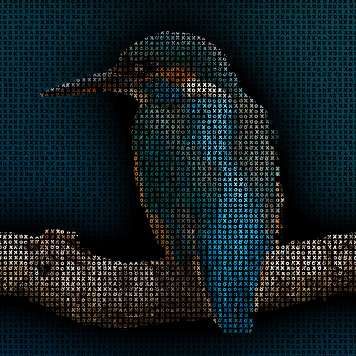

Numbers game by CFandM although this is not the same as you want it to appear by luminance
Is very important that you see the comments thread to know how it works and use it

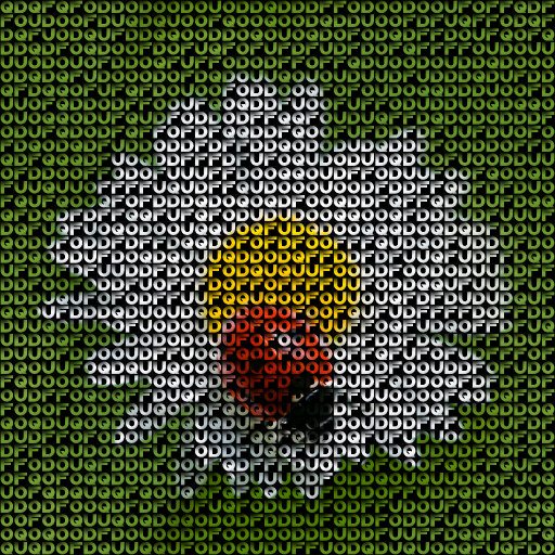

I have also made a filter that will let you use letters instead of numbers, and you can configure them as you want, and I made the letters big and bold so they are clearly seen and shown, I tell this because I have seen that maybe your own numbers may be small and not seen correctly considering that the repeat amount is high that reduces the size of the particles
Alphabet photos by SpaceRay
