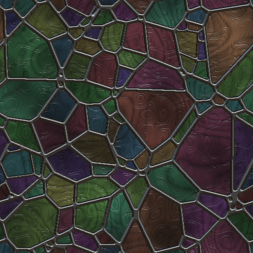

Here I show a way to add lines edges to a Cells noise a simple way
And for another example of adding edges to cells noise or any kind of shapes here is this excelent filter made by skybase
Stained Glass Lite by Skybase
And for a 3D version of these edges and using Variable Size tesselation
Stained Glass Generator by Zep Palen
